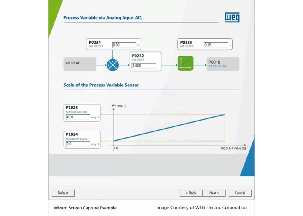

In comparison, modern VFDs with integrated PLCs can transfer primary control of the system to one of the other VFDs and the system can continue to operate and effectively eliminate a single point of failure scenario. In terms of installation ease, the VFDs feature intuitive setup wizards and pictorial graphics that guide users through the configuration of the pumping system, taking into consideration the number of pumps, pump speeds, pump protections and proportional-integral-derivative loop tuning. This reduces the complexity typically associated with programming and commissioning, making these systems accessible even to those with limited technical expertise.
Figure 2: Wizard screen capture example. Courtesy: WEG Electric Corp.

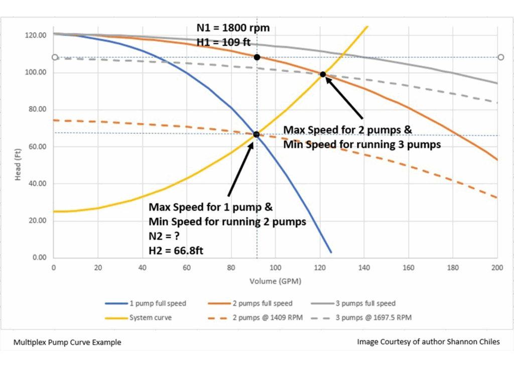

Optimized efficiency: To optimize energy efficiency, these VFD/PLC systems run pumps at the most effective speeds depending on real-time data from sensors. This minimizes environmental effects and lowers energy usage, which not only lowers operating expenses but also helps sustainability programs.
Additionally, by proper use of pump curves and affinity laws, minimum pump speeds can be determined to maximize flow and reduce wasted energy.
In the above example, we can use the affinity law relating head to speed. That formula is:
H1/H2 = (N2/N1)²
Because we are looking for N2, the formula can be rewritten as:
N2=N1/√(H1/H2)
Where:
H = head
N = speed
By plugging in our values, we find that two pumps running at 1,409 revolutions per minute (rpm) pumping the same volume as onepump running at 1,800 rpm at the point of intersection with the system curve. When the minimum speed value for two pumps running is entered into the integrated VFD pumping system, the system then operates at maximum efficiency without a decrease in volume. The same type of calculation can be done for the above to find out the minimum speed required when running three pumps.

Figure 4: Multiplex pump curve example. Courtesy: WEG Electric Corp.
